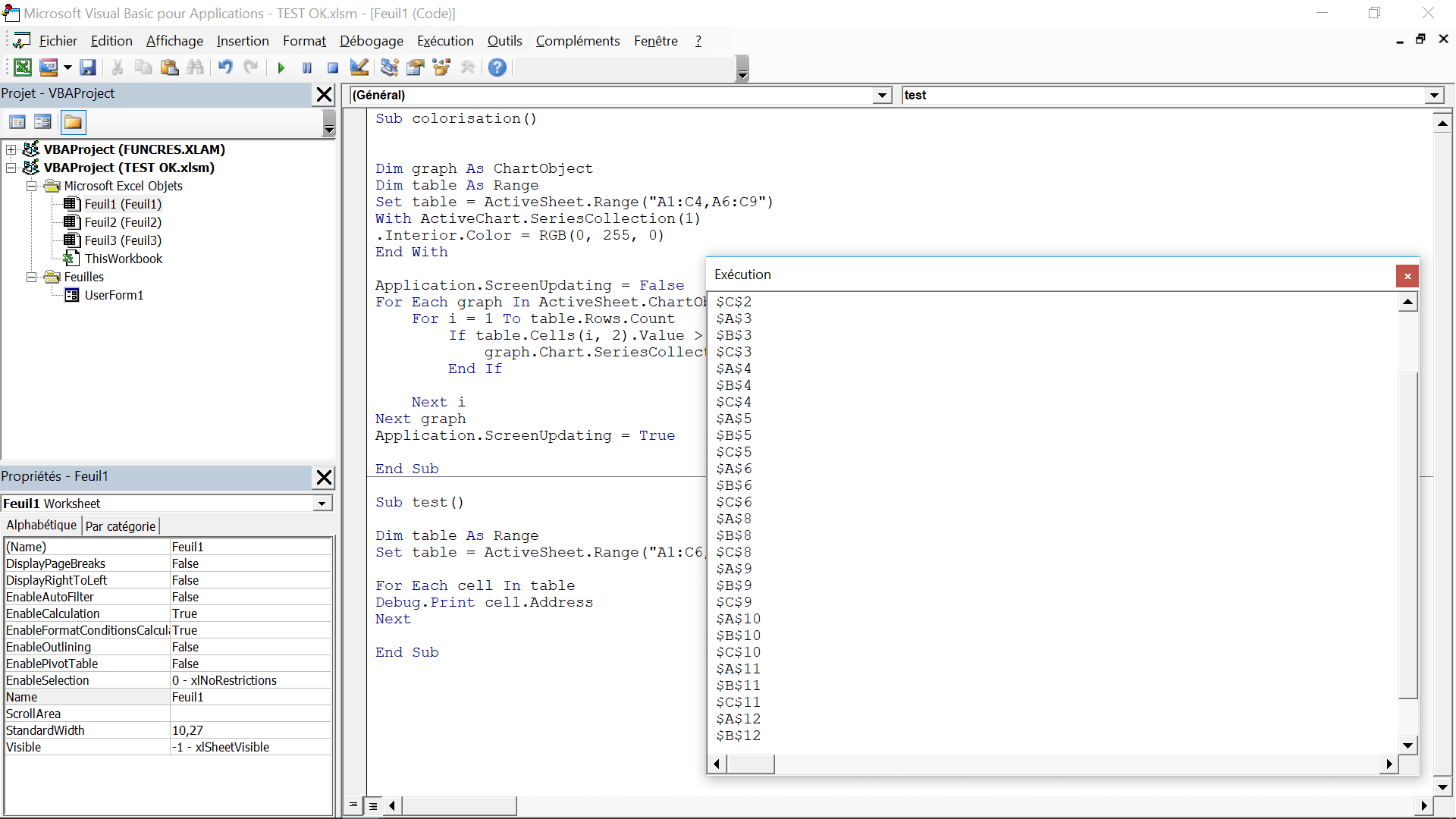

petit soucis :
capture d ecran 113

Sub test()
Dim table As Range
Set table = ActiveSheet.Range("A1:C6, A8:C12")
For Each cell In table
Debug.Print cell.Address
capture d ecran 114
