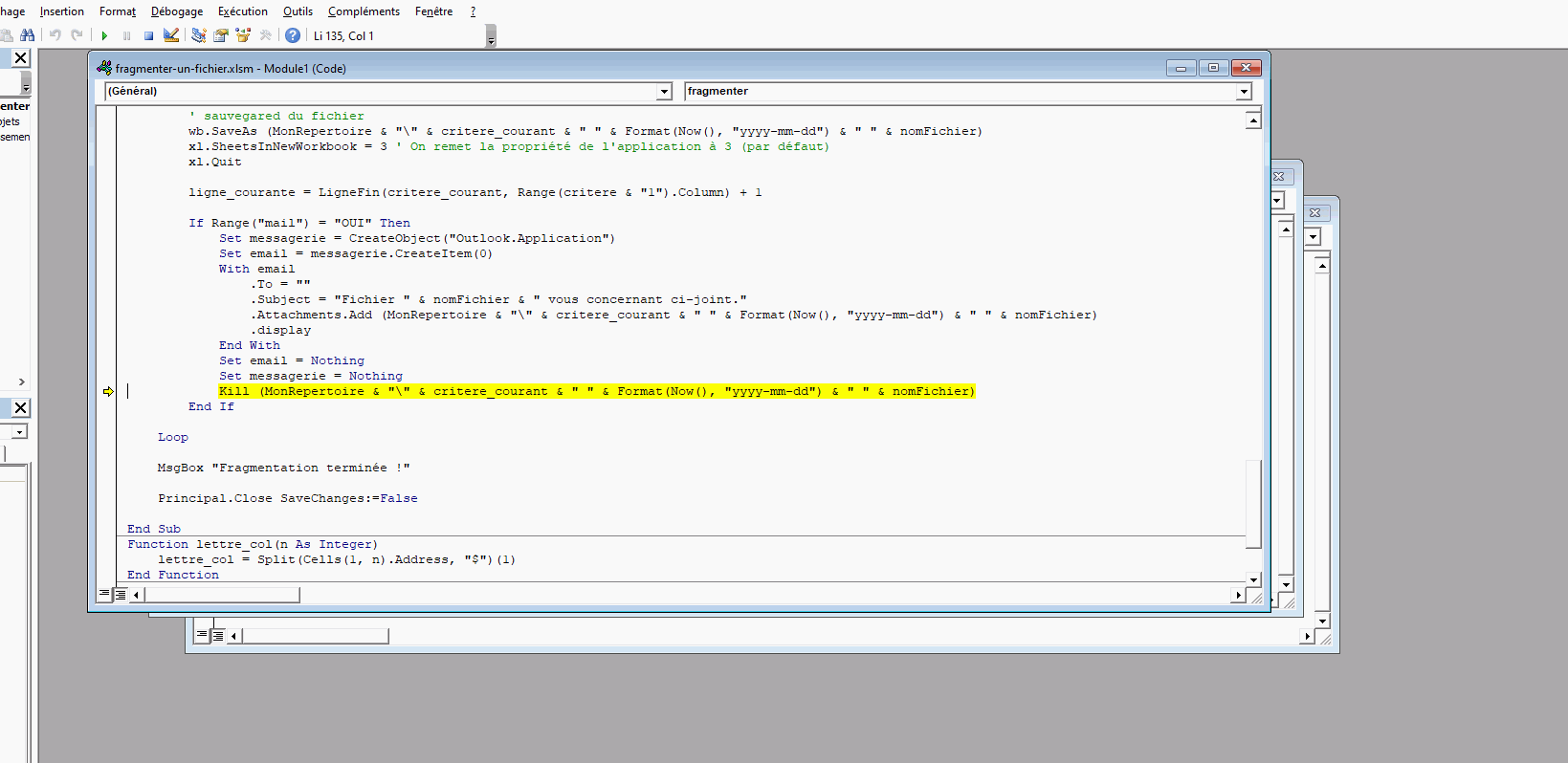

bon j'ai télécharger une macro de ce forum , il fragmente bien le fichier mais j'ai des pbm lors de l'envoie des mails .
Ci joint le macro

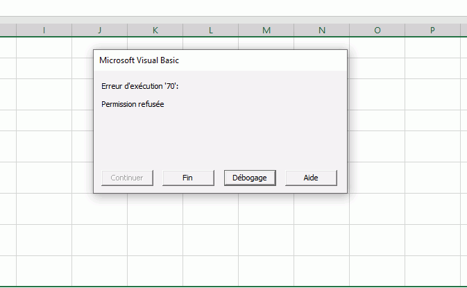

voici le message d'erreur qui s'affiche
capture capture 2
Bonjour Afef,
voici ma proposition, je te conseille de tester le code avec une version réduite de ton fichier
Sub mailAfef2()
'https://forum.excel-pratique.com/excel/fragmenter-un-fichier-excel-et-les-preparer-en-mail-196268
    Dim targetWorkbook As Workbook
    Dim objFSO      As Object
    Dim varTempFolder As Variant, v As Variant
    Dim OutApp      As Object, OutMail As Object, rng As Range, i As Long
    Dim AttFile     As String
    v = Range("A2").CurrentRegion.Value
    Set OutApp = CreateObject("Outlook.Application")
    Set objFSO = CreateObject("Scripting.FileSystemObject")
    varTempFolder = objFSO.GetSpecialFolder(2).Path & "\Temp " & Format(Now, "dd-mm-yyyy- hh-mm-ss")
    objFSO.CreateFolder (varTempFolder)
    With CreateObject("scripting.dictionary")
        For i = 2 To UBound(v)
            If Not .exists(v(i, 2)) Then
                .Add v(i, 2), Nothing
                With ActiveSheet
                    .Range("A1").AutoFilter 2, v(i, 2)
                    Set rng = .AutoFilter.Range
                    Set targetWorkbook = Workbooks.Add
                    .UsedRange.SpecialCells(xlCellTypeVisible).Copy targetWorkbook.Worksheets(Sheets.Count).Range("A1")
                    AttFile = v(i, 2) & "- " & Format(Now, "dd-mm-yyyy") & ".xlsx"
                    With targetWorkbook
                        .ActiveSheet.Columns.AutoFit
                        .SaveAs varTempFolder & "\" & AttFile
                        .Close
                    Set OutMail = OutApp.CreateItem(0)
                    With OutMail
                        .to = ""
                        .Subject = "mon sujet" '<<==== A' adapter
                        .HTMLBody = "test" '<<==== A' adapter
                        .Attachments.Add varTempFolder & "\" & AttFile
                        .Display
                        ' .Send
    With objFSO
        .deletefile varTempFolder & "\*.*", True
        .DeleteFolder varTempFolder
