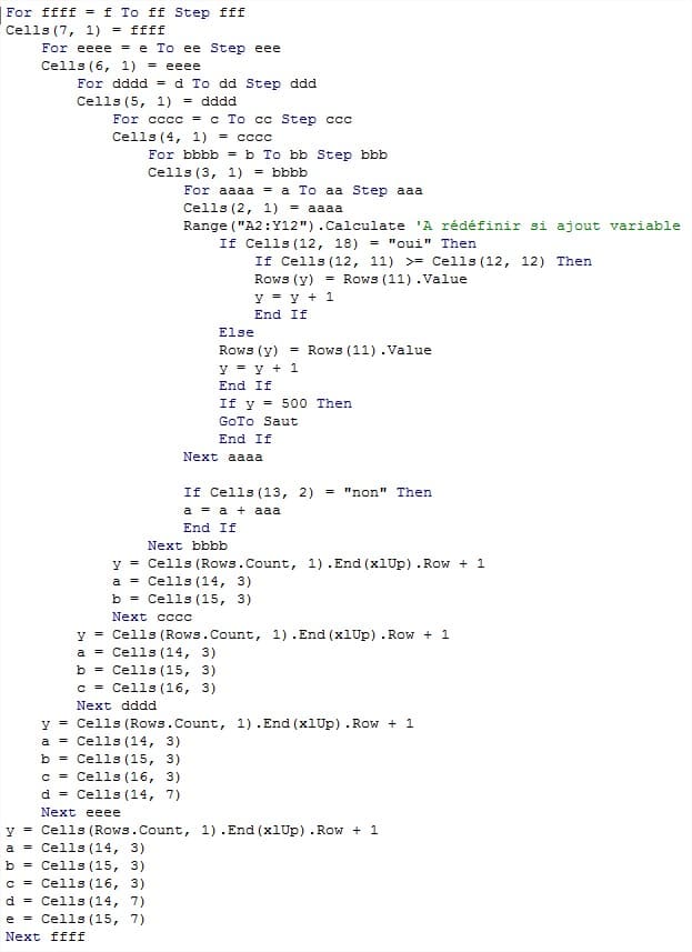

Voici la macro (que vous retrouverait dans le fichier)

For ffff = f To ff Step fff
Cells(7, 1) = ffff
For eeee = e To ee Step eee
Cells(6, 1) = eeee
For dddd = d To dd Step ddd
Cells(5, 1) = dddd
For cccc = c To cc Step ccc
Cells(4, 1) = cccc
    For bbbb = b To bb Step bbb
    Cells(3, 1) = bbbb
        For aaaa = a To aa Step aaa
        Cells(2, 1) = aaaa
        Range("A2:Y12").Calculate 'A rédéfinir si ajout variable
        If Cells(12, 18) = "oui" Then
        If Cells(12, 11) >= Cells(12, 12) Then
        Rows(y) = Rows(11).Value
        y = y + 1
        y = y + 1
        If y = 500 Then
        GoTo Saut
                Next aaaa
        If Cells(13, 2) = "non" Then
        a = a + aaa
        Next bbbb
     y = Cells(Rows.Count, 1).End(xlUp).Row + 1
     a = Cells(14, 3)
     b = Cells(15, 3)
 Next cccc
     a = Cells(14, 3)
     b = Cells(15, 3)
     c = Cells(16, 3)
Next dddd
    a = Cells(14, 3)
    b = Cells(15, 3)
    c = Cells(16, 3)
    d = Cells(14, 7)
Next eeee
    a = Cells(14, 3)
    b = Cells(15, 3)
    c = Cells(16, 3)
    d = Cells(14, 7)
    e = Cells(15, 7)
Next ffff
Application.Calculation = xlCalculationAutomatic
Cells(12, 14) = Now
Cells(12, 15) = Cells(12, 14) - Cells(12, 13)
MsgBox "Opération terminée"
Exit Sub
Saut:
MsgBox "Affinez les bornes sélectives"
D'avance merci pour votre temps et votre aide,
Bien à vous.

juste déclarer les variables de boucles DIM a as integer
vrai de a à aaaa, b à bbbb etc....
et présenter le code comme ci-joint
bon courage
