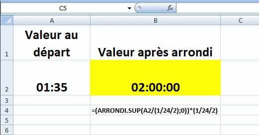

Essayez ceci
=(ARRONDI.SUP(A1/(1/24/2);0))*(1/24/2)
Cdlt

Pourtant:
sasha2412
